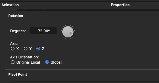

Possibly 720 is too much for so short run?
Works well for me with 72
14
Thanks, Tried your changes, but unfortunately no luck, we are getting rotation on the z access but as soon as I add the translation animation we get no rotation.

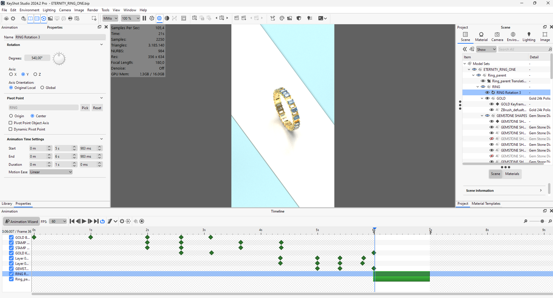

Just add the entire ring group to a parent group. That parent group can use the translation animation. So the ring looks like rolling along the path.
I changed the rotation angle to +540 degree and hid some gem stones to show the rolling. But the rotaion angle could be tweaked a bit. (e.g. 373 degree)
Hope that helps
CheerEO
Marco
Thanks alot. That helps alot.
So add rotation to the Ring in the Sub Grop then and the transition to the actual parent group.
ah yes - as shown in the screen grab.
Thanks got it working, i’ve been wanting to do more of these type of animations and you’ve helped a lot! Spent last night just doing and redoing animations to get them in my head.
